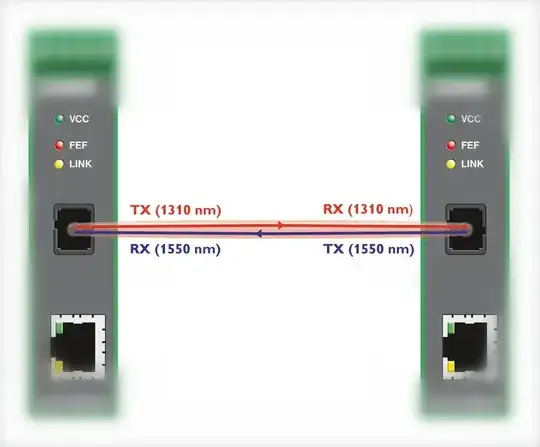

A full duplex or Bidirection communication meaning that it can support both stations transmitting and receiving simultaneously.
To accomplish this, a single optical fiber with WDM technology is required for optical tommunication.
WDM stands for wavelength division multiplex. This multiplex method uses both 1310 nm and 1550 nm wavelengths.Two devices are used for connection via a single optical fiber just as seen in the picture. Device A transmits data at 1310 nm on the TX channel and device B receives data at the same wavelength on the RX channel. When the roles are reversed, 1550 nm is used in the other direction. Connection is therefore only possible between device A and device B. The devices are available as a set.
Note that Cisco 1000BASE-BX10-D and 1000BASE-BX10-U SFP is availble for Single-Fiber Bidirectional Applications.
