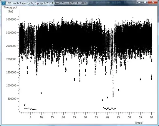

I didn't use iperf -w, so I think there is a misunderstanding. Since you have so many questions about the wifi case, I'm including a wireshark graph of TCP throughput for the wifi single TCP stream case.
Wifi TCP single-stream throughput
