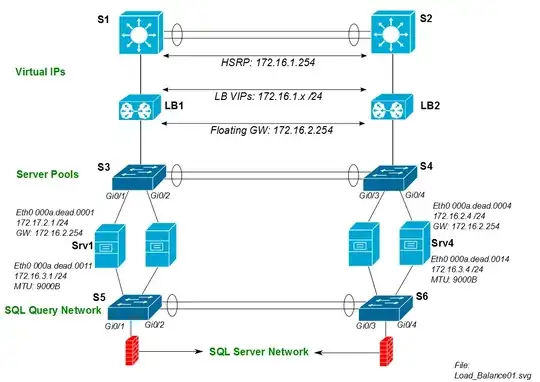

    Normally, I advise against the one-armed load-balancer design (or you might call it load-balancer on a stick), and go with a front-side subnet for load-balanced VIPs, and a back-side subnet for the server pools. The servers default through the back-side interface on the load-balancer. This completely eliminates the need for SNAT or PBR. – Mike Pennington Sep 07 '13 at 13:38
  • Aside from my comment about load-balancer topologies... could you add a few diagrams for reference, because some of the question is unclear when you're not sure what the bigger picture looks like. – Mike Pennington Sep 07 '13 at 13:40

Typically this is the best topology for load-balanced services that require SQL queries...
  • Put your VIPs on a front-side subnet... 172.16.1.0/24 in the diagram
  • Put your server pools in a back-side subnet... 172.16.2.0/24 in the diagram
  • Put your SQL queries on another interface... 172.16.3.0/24 in the diagram. Add a second interface to all servers that require SQL queries. Make all your SQL queries to addresses on this subnet. This topology works for both Unix and Windows, since you're only relying on ARP or host-routes (depending on your preference) for SQL connectivity.
Diagram:
LB w SQL query network
This topology has additional benefits:
  • It separates SQL interfaces from web traffic, since SQL queries are bursty and may wind up congesting web traffic.
  • It provides different MTUs for your load-balanced services (which usually need to stay at 1500 or lower, if they transit the internet) and your SQL services (which favor jumbo frames).
Any one-armed load-balancer topology is a less desirable option since you wind up cutting your max throughput in half because of the one-armed topology.

  • I had already eliminated this design option as it requires L2 adjacency between the front-end tier and the back-end tier as well as not scaling well for our multiple back-end VLANs and because of the potential need to place a firewall (not transparent) between tiers. However, it's still an excellent option for those who don't have these concerns. Good point about the MTUs. – generalnetworkerror Sep 14 '13 at 07:01
