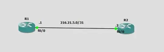

Why do I get % Warning: use /31 mask on non point-to-point interface cautiously when I use a /31 subnet mask over Ethernet, and why am I not able to ping from R1 to R2 when both the interfaces have accepted the /31 subnet mask and they both are directly connected, and in which conditions can I use /31 without any trouble?
R1#show running-config interface fastEthernet 0/0
Building configuration...
Current configuration : 107 bytes
interface FastEthernet0/0
 ip address 216.21.5.1 255.255.255.254
 shutdown
 duplex auto
 speed auto
end
R2#show running-config interface fastEthernet 0/0
 ip address 216.21.5.2 255.255.255.254
 shutdown
 duplex auto
 speed auto
end
Topology:
Ron Maupin
  • 99,565
  • 26
  • 120
  • 195
Heisenberg
  • 347
Your problem is that you are addressing in two separate networks: 216.21.5.0/31 and 216.21.5.2/31. The addresses you are using are in the same /30 network, but two separate /31 networks.
You need to set one address as 216.21.5.0 and the other address as 216.21.5.1, or set one address as 216.21.5.2 and the other address as 216.21.5.3.
The warning is because ethernet is a broadcast technology which can have multiple endpoints, but a /31 network can only use two endpoints. If you were configuring it on a true point-to-point medium, I don't think you would get the warning.
Ron Maupin
  • 99,565
  • 26
  • 120
  • 195
Using /31s is specified in RFC 3021 (Using 31-Bit Prefixes on IPv4 Point-to-Point Links).
Not all operating systems support this, especially Windows. And there are probably other system out there which do not support this RFC.
So using a /31 will not work with every connection and router gives you a friendly warning.
Also, you could do "no shutdown" on relevant interfaces :)
