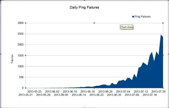

We have a strange problem. Our nms admin sees very bad packet loss that started sometime in June. The packet loss is growing very fast, but we do not know why. Traffic through the firewall has remained constant, but packet loss is growing quickly. These are the nagios ping failures we see through the firewall. Nagios sends 10 pings to every server. Some of the failures loose all pings, not all failures loose all ten pings.
