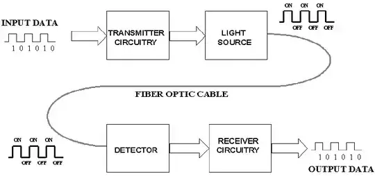

the answer of this question is depend of how we under stand data transmission across fiber optic ??
lets say we have a group of 0's and 1's represent the data need to be transferred from end to end . simply across the fiber optic ,transmitting such data is by turning laser light on for interval to represent 1 and turn it off for interval to represent 0 , this behave of sending data is DIGITAL the next figure show basic transmit and receive based on this concept enter image description here
