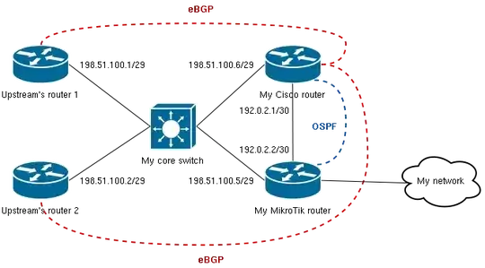

Network diagram - core
192.0.2.1 is default gateway for MikroTik router (192.0.2.2).

  • Perhaps I'm misunderstanding what you're trying to accomplish, but how would configuring what you describe help you not needing to do eBGP on that Cisco router? A network diagram may help a lot here, but what you're doing here won't work how you intend to. Also, what's 192.51.100.5? – Teun Vink Aug 20 '15 at 05:12

  • @TeunVink I need to keep eBGP on Cisco router, but it can't deal with all our current network traffic anymore. There is no 192.51.100.5... but 198.51.100.5 is my MikroTik router, as described. – Tiago.SR Aug 20 '15 at 18:08
  • @Jimmy Cisco router is directly connected to my dedicated circuits with upstreams. MikroTik router can be added to same Ethernet segment by VLAN and bridge, becoming the 198.51.100.5. It's Ethernet. I'm trying to change this default behavior by manually setting next-hop to MikroTik router's IP address using set ip next-hop... on Cisco. I'll draw a network diagram and update original post as soon as possible. – Tiago.SR Aug 20 '15 at 18:14
  • Updated question's post. Is it better now? – Tiago.SR Aug 21 '15 at 03:20
