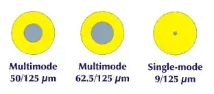

    Terminology nitpick - the cladding is is the outer part of the glass, and never has anything written on it (nor can it be removed.) The buffer is the acrylate layer over the glass, and also never has anything written on it. The place where the fiber type should be imprinted every 2-3 feet is the jacket. – Ecnerwal Jul 28 '15 at 16:00
If you have a fiber scope (you really should, to check if connections are clean) the core size (but not OM level) is obvious by inspection, especially if you look at a known connector and then the unknown connector (or better yet, two known connectors, one of each size.)
Image from theFOA.org
Ecnerwal
  • 2,746
  • Remarkable how few decent images there are on the web with an accurate representation of the core sizes. – Ecnerwal Jul 28 '15 at 16:07
    For those not familiar with fiber, in the above image the grey is the core size and the yellow is the cladding. If you are looking at this through a scope, many new users mistakenly think the ferrule (white) is the cladding and the cladding (grey) is the core (white). In some conditions or with the focus a bit off, you may not see the core clearly. You can get an idea of what I am trying to say if you search images on your search engine of choice. – YLearn Jul 29 '15 at 02:32
