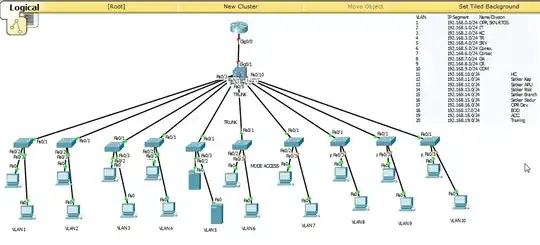

I'm testing a network and I use the vlan among 20 vlan but in this packet tracer I just use 10 Vlan on my network,
In this case, I use the DHCP server on my multilayer switch, not on my router.
so on the port on multilayer swith to switch layer 2 I use:
switchport trunk encapsulation dot1q
switchport mode trunk
for the DHCP server on multilayer switch I use:
ip dhcp pool vlan1
network 192.168.0.0 255.255.255.0
default-router 192.168.0.1
and the same for other vlan.
I have add the vlan and the IP address like on the picture
but when I config on the all switch layer 2,
on fa0/1 who connected to multilayerswitch I use:
and port fa0/2-3 who connected to PC I use:
switchport mode access
switchport access vlan <VLANID>
! VLANID == VLAN for respective switch
But there's some thing weird,
On VLAN 1 and 2 it's almost connected and get the dhcp ip success but on the other PC I cannot get the DHCP IP it's remarks "dhcp failed. apipa is being used"
please help,

  • Did you configure VTP or add the VLANs to all the L2 switches? Run the following command on one of the L2 switches where it isn't working and edit it into the question: sh interface trunk – YLearn Nov 09 '15 at 23:36
  • Try packet tracers simulation mode. – IsAGuest Feb 08 '16 at 07:19
  • i faced the same issue with my lab, the problem it was the VLAN interfaces in the L3 switch, after that everything were working perfectly. thank you guys for your comments they were very useful. –  Oct 09 '16 at 13:19
  • I should check a few things:
    - if the access port are belongs to the desired vlan on L2 Switch
    - if the desired VLANs are present on L2 Switch
    - if the VLANs are allowed on trunk interface
    - if the SVI's are up on Multilayer Switch
    - and then fainally the DHCP pools
    let me know
    – new_py Jan 09 '17 at 00:42

The ports connecting from to L3-sw to L2-sw and L2-sw to L3-sw both need to be trunked to carry all the vlans.
And the port connecting to pc should be access and assigned to the vlan you want.
Also create both the vlans on L3-sw along with the interfaces for those vlans.
If you want inter-vlan routing then also enable:
conf t
ip routing
allwynmasc
  • 394
You should check a few things:
  • if the access port are belongs to the desired vlan on L2 Switch
  • if the desired VLANs are present on L2 Switch
  • if the VLANs are allowed on trunk interface
  • if the SVI's are up on Multilayer Switch
  • and then fainally the DHCP pools
If you have any other problem please attach the show running-config of the Multilayer Switch
