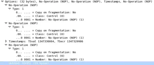

When using the authentication-key-chain, etc. the packet capture didn't give me the TCP authentication options I'd expect (I can provide full captures if necessary):
cap-1

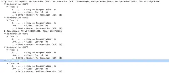

Here's what I would expect using MD5 authentication:
cap-2
As you can see, MD5 is explicitly called out in the capture.
