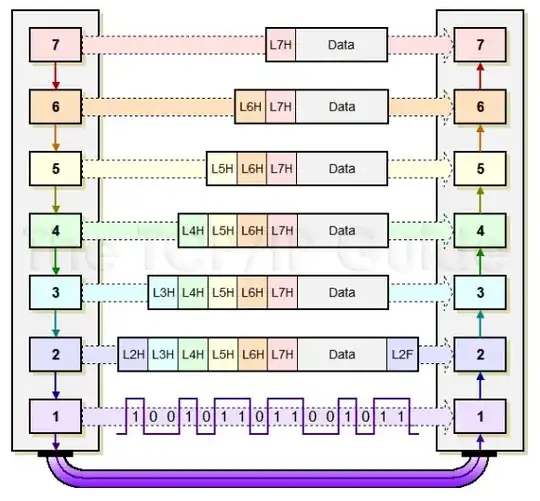

OSI Model
OSI Model
Source: TCP/IP Guide
What layers encapsulate the data depends on what generates the data. In general, de-encapsulation will only happen for what is relevant to the data's current place in the network (on a router, on a host, etc.)

  2. [Layer 7] Your PC/Server will generate an HTTP GET request to send toward your specified webserver, in this case we're talking about google.com. So if you look above, we have that GET request, which is considered "data". HTTP is a layer 7 protocol, we're going to add that header. Because there is nothing else to do at this layer, lets pass it down to layer 6.
  3. [Layer 6] We can think of layer 6 as how the data should be formatted, for a website nothing is really going to happen here, but an administrator/developer/engineer could do something with this if they chose to. Our PC/Server is still going to add a header on top of the layer 7 (HTTP) header, and send it down to layer 5.
  4. [Layer 5] At this point because our PC/Server knows we're trying to contact a webserver, we need to make this request in a format the application as a whole can understand, for this we use an Application Program Interface (API). This is what manages the applications session, this is so the web server will know what "stream" the data is a part of. Let's add our layer 5 header, and pass it down to Layer 4.
  5. [Layer 4] Network engineers care about all data, but this is where it starts to get very specific for us. Layer 4 is our transport layer, this is where we decide how our data gets there, not the path, but how - i.e. TCP or UDP. In this case, our PC/Server needs to establish a connection with the web server. I'm going to skip over some things for simplicity, but this is where your typical TCP 3-way handshake would happen. We encapsulate what we currently have in a TCP header, this contains things like source and destination port numbers, sequence and acknowledgment numbers, and TCP windowing information.
  6. [Layer 3] Here's the other layer we as engineers really care about, the network layer. This is where packets are addressed to their destinations, we need IP addresses to get to places on a network. Our PC/Server will add its source and destination IP address. Not only will the packets get to the right destination, but that endpoint will use our source IP address to send it back to us when it needs to send us data of any kind. Now, something to note here is that even PCs/Servers can have multiple interfaces, so we need to send the data to the correct place. Our PC/Server will have a routing table just like routers, typically if your a host of some kind, your packets will be routed to your default gateway in the hopes that it will know how to get the packet to its destination. Lets add that IP header and hand it off to the data link layer.
  7. [Layer 2] Our PC/Server's network interface card (NIC), doesn't know how to speak IP on its own, so it uses media access control (MAC) addresses to move that data. Your PC/Server is going to have ARP entries for each IP it can reach, so in this case its going to have an entry for your default gateway. Your gateways IP address, will correlate to a destination MAC address. So let's add our L2 header that destination MAC address, this header also contains our PC/Server NIC's MAC address as the source. Now we have everything we need to put that data onto the wire as bits.
  8. [Layer 1] As you mentioned in your question, this is where the data flows over the wire, it's where we see the raw 1's and 0's. Now there isn't a Layer 1 header per se, if you look at the diagram on layer 2 you'll see that. The data that is up until now which has all of the headers from L7 down to L2, will be converted to those 1's and 0's.
  9. Now we have bits on the wire, on it's way to your gateway router. Up until this point, your PC/Server has done ALL of the work encapsulating the data that bound for google.com's web server.
