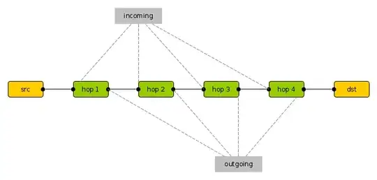

The Unix command traceroute traces the IP addresses of the nodes from a source node to a destination node. Every node in between has an incoming and an outgoing interface.
traceroute
Executing traceroute -n dst on src will show the IP addresses of src, dst and all incoming interfaces of the hops in between.
But how to trace the outging IP addresses?

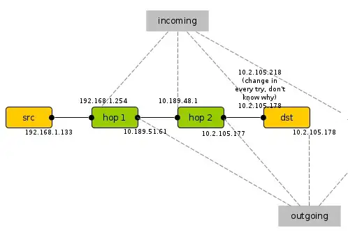

I's not exactly the answer at your question, but that a simple (but limited) way to do (in certain case) what you want. I'm coping-post the option -R of ping man page:
-R Record route. Includes the RECORD_ROUTE option in the ECHO_REQUEST packet and displays the route buffer on returned packets. Note that the IP header is only large enough for nine such routes. Many hosts ignore or discard this option.
So you can see also the return path of the ECHO_REQUEST, that is not the exit interface (that you are asking about) unless the outgoing path is the same of the come back path. Only in this case, the returning path is the IP address of the outgoing interface you are asking for.
That's an real example on my internet provider net, maybe not so clear, but I don't have just now some router to link each other :) dest 10.2.105.178
traceroute 10.2.105.178
traceroute to 10.2.105.178 (10.2.105.178), 30 hops max, 60 byte packets
 1  192.168.1.254 (192.168.1.254)  3.418 ms  3.575 ms  4.021 ms
 2  10.189.48.1 (10.189.48.1)  11.237 ms * *
 3  10.2.105.178 (10.2.105.178)  15.235 ms * *
ping -R 10.2.105.178 PING 10.2.105.178 (10.2.105.178) 56(124) bytes of data.
64 bytes from 10.2.105.178: icmp_req=5 ttl=253 time=74.1 ms NOP RR:
192.168.1.133
10.189.51.61
10.2.105.177
10.2.105.178
10.2.105.178
10.189.48.1
192.168.1.254
192.168.1.133
----omitted----
64 bytes from 10.2.105.178: icmp_req=6 ttl=253 time=13.0 ms NOP RR:
192.168.1.133
10.189.51.61
10.2.105.177
10.2.105.178
10.2.105.218 ##change every time, Idon't know why##
10.189.48.1
192.168.1.254
192.168.1.133
feligiotti
  • 354
  • I am not sure if I understood correctly what RECORD_ROUTE does, but it does not seem to be, what I need. I tried it with a dial-up connection. I know the public address of my dial-up router and I have a route of nine hops to a public web server. For each of the hops I tried the -R option. The fourth hop was the first, who answered the request. But the answer does not contain my public address. And although it was only the fourth hop the answer contains 9 addresses. – ceving Oct 08 '14 at 10:26
  • just a moment, I'm preparing an exemple – feligiotti Oct 08 '14 at 11:07
  • The ping -R shall be useful only for very limited hop. I say before that is a restricted way – feligiotti Oct 08 '14 at 12:16
  • The same example does not work for my dial-up network. I have no idea why. Maybe NAT? – ceving Oct 08 '14 at 13:51
  • Hi @Ceving, do a traceroute 212.227.222.9 and then do a ping -R to the third hop you found in the traceroute. In that way you have the same schema I did to read the response. The nine route total mean go and come back, so if you do ping -R 212.227.222.9 you can't see the full path, but only the last part – feligiotti Oct 08 '14 at 15:47
  • the "remote address", I think, isn't the IP address of your access point, but a nat done by your internet provider. Or better, that what happen to me, that use fastweb. Really don't know the Deutsche Telekom policy. Cheers – feligiotti Oct 08 '14 at 16:08
  • Tx @YLearn So, if I understood, the reason that the address 10.2.105.218 ##change every time, Idon't know why## flapping every icmp_req shall be originate by a sort of "random loopback interface". Correct? – feligiotti Oct 08 '14 at 21:30

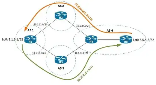

According to RFC1812 the source address of ICMP message generated by the router should be that of the egress interface over which the packet would normally return to the sender.
In reality, it is very likely that you will face non-standard behavior where router will source the ICMP reply with the source of ingress interface. This usually make the traceroute much easier to read.
As a follow-up to YLearn's question I'm posting a network diagram and some outputs. Sample topology to illustrate how traceroute works
Let's assume we are souring the traceroute from R5's loopback 5.5.5.5 to R1's loopback 1.1.1.1. As you can see, the forward path is via R4-R2, while reverse path is R3-R4.
R4#sh ip route 1.1.1.1
Routing entry for 1.1.1.1/32
Known via "bgp 4", distance 20, metric 0
Tag 2, type external
Last update from 10.1.24.2 00:02:42 ago
Routing Descriptor Blocks:
* 10.1.24.2, from 10.1.24.2, 00:02:42 ago
  Route metric is 0, traffic share count is 1
  AS Hops 2
R1#sh ip route 5.5.5.5 Routing entry for 5.5.5.5/32 Known via "bgp 1", distance 20, metric 0 Tag 3, type external Last update from 10.1.13.3 00:14:18 ago Routing Descriptor Blocks:
  • 10.1.13.3, from 10.1.13.3, 00:14:18 ago Route metric is 0, traffic share count is 1 AS Hops 2 Route tag 3 MPLS label: none
The traceroute output from R5 looks as following:
R5#traceroute
Protocol [ip]:
Target IP address: 1.1.1.1
Source address: 5.5.5.5
Numeric display [n]:
Timeout in seconds [3]:
Probe count [3]:
Minimum Time to Live [1]:
Maximum Time to Live [30]:
Port Number [33434]:
Loose, Strict, Record, Timestamp, Verbose[none]:
Type escape sequence to abort.
Tracing the route to 1.1.1.1
VRF info: (vrf in name/id, vrf out name/id)
1 10.1.45.4 208 msec 140 msec 100 msec
2 10.1.24.2 96 msec 44 msec 104 msec
3 10.1.12.1 224 msec 220 msec 112 msec
So while the actual ICMP traffic generated by R1 is going back to R5 via R3, the IP header of ICMP Unreachable message will have the source of ingress interface 10.1.12.1.
In my experience this how Cisco and Juniper routers behave, I'm not sure about other vendors.
mkurek
  • 628
  • Probably just me, but the second sentence has me a bit confused. Are you saying it is common for a device on the internet to respond using the ingress interface of the traffic that caused the generation of the ICMP message? So if the traffic is received on Int1, and the ICMP message goes out Int2, it is sourced from Int1? Or are you referring to a different ingress interface (and if so, which)? In my experience, most routers work as the RFC states, using the egress interface of the message by default, and that in most cases this is the same interface the traffic was received on. – YLearn Oct 08 '14 at 20:21
