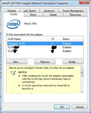

NIC and Driver with VLAN Support
I have had success using Intel mobile adapters that support VLANs on Windows desktop OSes. In that case, the Intel driver adds a special VLANs tab to the properties dialog box.
In that dialog box you can create different virtual network adapters for each VLAN, which you can enable and disable to switch between the VLANs.
