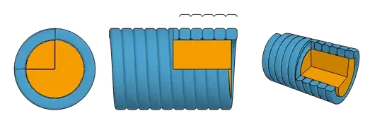

The terms are "wound" and "unwound" or "plain".
The larger gauge strings are a thin wire wrapped around a solid core. If a larger wire was simply used then it would be stiff and inflexible.
alt text
Take this cross-section. Now imagine it being bent in the middle. The wrapped blue wires move apart slightly as the string is bent and that's what makes it more flexible.

  • The diagrams are great, but can you explain why flatwound strings sound different than roundwounds? Also, can you explain why we use wound strings at all? Why aren't all strings just plain? – Alex Basson Jan 21 '11 at 19:51
  • The latter was explained. The former, I'm not sure about. –  Jan 21 '11 at 21:27
  • Flatwounds lose some harmonics from getting ground down. At least that's what I remember from a string factory tour in a Guitar rag from the 80s. :) –  Mar 05 '11 at 13:06
    How did you make those pretty pictures? – luser droog Oct 20 '11 at 05:40
