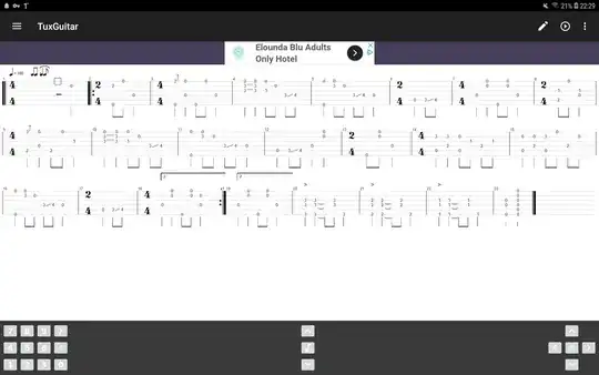

*emphasized text*I have a Guitar Pro 5 tab which only plays 17 bars then stops.
Not just with Tux but all other players.
How do I change GP5 so it plays all 18 bars?
I've noticed that the volta bracket in bar 18 is numbered as "2.", but should be "1.".
This might cause an error which stops the song when playing.

    That worked - brilliant - had to go onto my pc to correct it though. – Ms annette elmore Oct 28 '19 at 13:00
