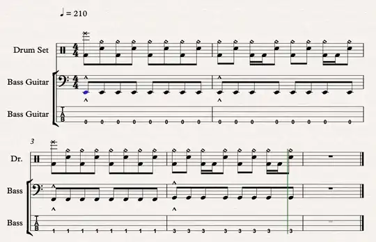

Marcato probably? Works as note accent
Sibelius_bass
See that up arrow? That's the accented note. So just use that on the notes you need and then insert a repeat to organize the score more economically.
IDK what's your song structure or time signature, but based on your "tab" it might look like this (thanks to AlbrechtHügli for mentioning): enter image description here
