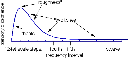

The reason for this is that this kind of dissonance curve (for complex tones) is derived from the dissonance curve for simple tones, i.e. single sine waves:
tonal consonance
And as you can see, this shows that very small differences are still quite consonant; slightly larger differences are more dissonant, and then even larger differences show less dissonance.
So "an interval's acoustic consonance is a function of how "simple" it is as a ratio" isn't true if we take it too literally. It might still be a reasonable statement if restricted in scope to being a 'discrete' function only dealing with justly-intoned common musical intervals, which in some contexts would be the 'intuitive' way to interpret it.
