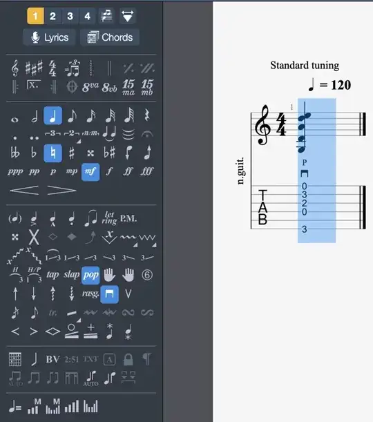

In Guitar Pro (a common tablature reading/writing software), you can achieve this P symbol by selecting the note/chord and selecting the pop option in the editor:
Guitar Pro screenshot of editor
If I were to hazard a guess, I would say that the tab author probably wants to indicate that at this point you need to lightly slap the lower (or lowest) string with your thumb as you play. This is a very common acoustic guitar technique and when you listen to this song, you will likely hear a light "slap" sound at this point as Sungha Jung lightly slaps the lowest string with his thumb here.
In fact, listening to the song on YouTube, he starts doing this around 30 seconds in.
An alternative interpretation could be that it is indicating where the percussive thumps go (which start around a minute and a half in), but it depends where in the song your tab is from.
Either way, I believe this to be a percussive marking rather than a dynamic or fingering one as others have suggested.

  • This is kind of helpful but at 30 seconds in there is no P symbol in the tab and it looks more like a regular thumb slap to me. The sound later is different and has a louder twangy vibe to it – JSASCS Jul 31 '19 at 02:10
  • That's interesting. So what timestamp in the song is this tab from? – James Whiteley Aug 01 '19 at 09:38
  • Right before the chorus. Around 1:20ish. I also think I know what it is. When you slap a string but let your thumb bounce off the string to let it ring out. Im not sure and it doesnt really correlate to the tab nut that is what it looks like in the video. – JSASCS Aug 01 '19 at 18:32
  • Also do you have an email or somewhere I can dm u if you dont mind because I dont get notifications from this – JSASCS Aug 01 '19 at 18:36
  • @JSASCS I use the Stack Exchange mobile app to receive notifications from their sites (even if it is horribly buggy). Tbh I'm not comfortable giving my email out on a public site like this. I hope you can understand. – James Whiteley Aug 02 '19 at 10:46
  • I listened to the song (and watched the video) again, and I think you're partially right - at that point in the song, it looks like he almost uses the palm of his right hand to lightly thump the body of the guitar while playing the other notes. Or something like that at least. – James Whiteley Aug 02 '19 at 10:50
  • Regardless, I don't know how I would've transcribed this percussive thud but I don't think I would've used the P, at least not without some sort of key somewhere describing what I mean. – James Whiteley Aug 02 '19 at 10:51
  • Yea I understand the email thing. Also I think i got the correct answer here thanks for the help – JSASCS Aug 02 '19 at 15:26
