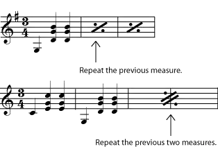

Usually they have a dot on each side and are often found in drum parts for example:
They are called 'Simile marks' and can also have more than one slash. One slash would usually mean to repeat the previous measure, two slashes would usually mean to repeat the previous two measures and so on....
So In this case it seems like to just repeat the last three measures. First because of the three slashes... and also because it's spread over three measures.
