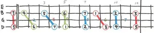

But, I feel like the result is my internal, mental map of the fret board is like this...
...there is a huge gap! It's like a Medieval map of the world with all of the New World missing.
It wasn't that I couldn't play anything on those strings 1-4. I could play just the portions of E and A form barre chords on strings 1-4. But I couldn't (still can't) move fluidly to any chord change when the voicing involved just the middle strings 2, 3, and 4, because I had to refer back to strings 5 or 6 to get my root and the rest of the chord's position across the middle strings. The "easy" short cut of finding chord roots on strings 5 or 6 became an anchor around my neck.
Eventually I made two charts...
Primary chords:
Thirds and sixths (with string 3 giving the tone to make complete triads):
...to help me better learn chords on strings 1 to 4 and to understand the repeating of the fretboard at the octave at fret 12.
Those images may not be an aid for you directly (they aren't the complete charts and I labelled them for my purpose at the time) but if you look for the chords root within them you will see that the roots fall in various places on strings 2,3 and 4.
If I had continued to practice guitar, learning this surely would have been indispensable, and eventually I would have learned all the roots on all the strings.
