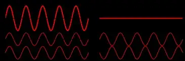

All of the answers here have been very good and informative, but one other thing I'd like to point out is that often times using compression on the master track can be beneficial to getting a crispy sounding final mix. I've learned over the years, from trial and error (and the Fl Studio manual), that a big part of loudness comes not from cranking everything up, but from cutting all the garbage out of the mix so that only what's needed can be compressed. If you try and boost EQ frequencies, you're not cutting out the noise. If you can cut as much noise and extra stuff out of the mix, compression on the master will sound a lot cleaner.
This has to do with the fact that the master can only handle so much sound. You want all of your instruments working harmoniously, not against each other. If you can cut your frequencies so that they are complimentary, you can take advantage of the wave interference principal as-well:
"In physics, interference is a phenomenon in which two waves superpose to form a resultant wave of greater, lower, or the same amplitude. Constructive and destructive interference result from the interaction of waves that are correlated or coherent with each other, either because they come from the same source or because they have the same or nearly the same frequency."
https://en.wikipedia.org/wiki/Wave_interference
So basically, if you try and simply boost a bunch of frequencies, you're fighting against the total headroom of the mix. If you creatively and craftily sculpt away the noise, you can take advantage of master compression and the wave interference principal.
Oh, and one other thing: the human ear/brain tends to perceive differences in loudness as contributing to said loudness. If you cut frequencies opposed to amplifying others, your mix will become more dynamic and thus the ear perceives differences in amplitude as creating a louder, cleaner mix.
I do occasionally boost eq frequencies in the 1.5-5khz range... but only when it's an extremely quiet recording and after I've cut all of the low frequencies. Then I use a bit of compression on the individual track to give it a bit of extra loudness. I've also heard of some people boosting 1.5-5k on the master ever so slightly (at the very end of a mix).. but I tend to just leave the master alone (other than multi-band compression). So boost extremely sparingly (from what I've read and experienced).
