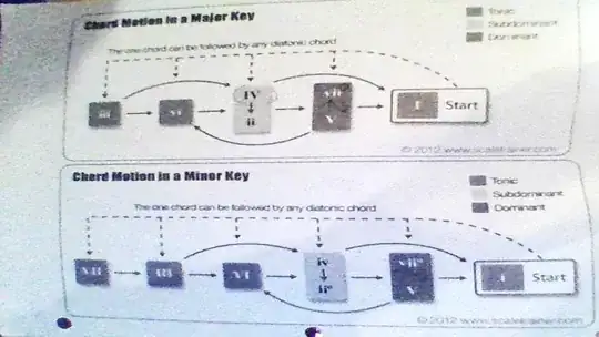

I'm wondering if chords usually move down by fifths. It seems so by the diagram, so iii to vi, vi to ii, ii to V, V to I. etc. Other chords can also be thought of like that, because IV/ii and V/vii are often interchangeable. So IV -> V can be thought of as ii -> V.
chord progression flow diagram
Is that the most typical movement of a chord progression?
See 4:55 in the video below. This is one of many teachers explaining this flow. I've seen this flow myself in plenty of songs I've played.

I think you are overlooking an important part of that flow chart: the curved arrow to the right of I means "the tonic chord can move to any other chord."
So, that results in a super common progression I ii6.
The rest of the flow chart does display descending fifth progressions with some options variations like IV ii and vii0 V.
Of course IV V is absolutely essential to functional harmony and that is root progression by step.
Step-wise movement of 1st inversion chords is completely missing from the flow chart.
Keep in mind that a lot of harmony by descending/ascending fifth will occur as sequential harmony. In terms of phrasing and structure in common practice those sequential passages don't just happen anywhere. There are structural conventions to consider.
Anyway, IV V, I ii6, and V vi are so super common that we really can't say progression by fifths is the usual movement.
The flow chart isn't "wrong" but it leaves out a lot of important information about formal structure and harmonic conventions in common practice music.

    That flow chart is found in many forms, but the original source is Kostka, Payne, Tonal Harmony. So it gets re-presented on the web, minus the 400 pages of text of the original book. That leave many unsuspecting webizens thinking they've found the holy grail of harmony in a single chart. I wish the rule of the octave was to top Google result instead! – Michael Curtis Apr 22 '19 at 17:39

I've seen this exact kind of chart in some of my education (ta-da!)
Diatonic Chord Motion
, so you're not alone. The image marks the work of www.scaletrainer.com, but I came into possession of it from an instructor. I've even seen the same diagram on musictheory.net (scroll down). But I quickly realised the limitations of the chart, and I get the feeling you already have as well.
