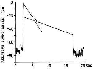

Here is the typical attack of a piano:
As you can see, no chance of a crescendo during the note length so whatever dynamic level it is at at the peak is the loudest it will be. The rest of it will get quieter at a relatively linear rate until the key is released.

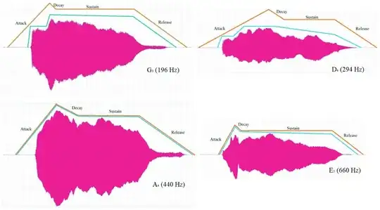

By contrast, here is a violin's attack:
As you can see, there is a natural crescendo in the attack so reaching extreme dynamics is no problem. It is one of many instruments that can do a 1 note crescendo or diminuendo. In principle all bowed strings, woodwinds, and brass can crescendo or diminuendo a single note.

You seem to be confusing the ADSR envelopes with the amplitude of the sound. It's true that the piano has a well-defined envelope which you can't do much to change barring the point of release, but the relative amplitude of the peak of the Attack is all completely within the player's control.
As such, if a pianist want to change dynamics, they just play softer, resulting in the hammers striking the strings with less force. The ADSR envelope is (largely) the same, but the peak reached changes.
For a single note, there's nothing that can be done, unlike on a constantly excited instrument such as the violin, but you'll notice that all of the crescendos and diminuendos in the piece you've posted are over a sequence of notes, meaning that each successive note in the sequence is played with a different attack, which results in the dynamic of the phrase following the marked indication. The same wouldn't be true if the piano was meant to crescendo over a held note, because as you correctly point out this isn't possible on a piano.
