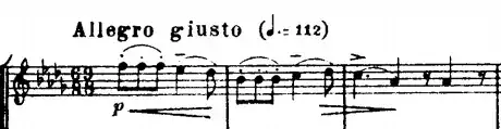

One way which is possible is to show two time signatures, as here from Tchaikovsky's second String Quartet via Popflock:
Multiple time signatures
This warns the user that bars of each length are to be expected.

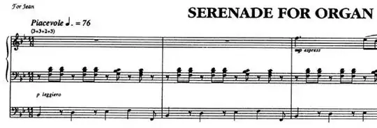

As a possible alterative to Richard's answer, you can write the total in the time signature and the division above the staff like this:
Serenade for Organ by Derek Bourgeois
This may be easier, depending on the capabilities of your notation software. However, it does imply that the divisions are the fundamental beats. In this case that is four beats to the bar, with beats 1, 2, and 4 being longer than beat 3. But in the original question the beats are implied to be all equal quarter notes.
However, that might prompt you to ask whether this is actually true? Or are the intended groupings really 3+2+3 (or even 2+3+3)? After all, 5/4 is almost always 3+2 or 2+3.

  • Nice point about 5 breaking down to 3's & 2's. Perhaps there will be cases where 3+2 or 2+3 isn't one constant pattern throughout, but when it is, it seems friendly to show the full additive breakdown. – Michael Curtis Apr 10 '19 at 14:44
    I was going to add that the Derek Bourgeois piece "Serenade" used 11/8 and 13/8 used this (there’s a wind band version plus score on YouTube). I found it quite intuitive to read. But I think that’s your example! – Pam Apr 10 '19 at 16:01
Most of the mixed-meter scores I've seen use non-dotted measure lines as well (and no "+" sign between the paired meter notations.) . It's just treated as "we will always be switching meter every bar" . See for example West Side Story "America" where it goes into 6/8-3/4 swap time.

    In this case what changes is the subdivision of the bar, not the total bar duration, so I don't think it really answers the question. – Ian Goldby Apr 10 '19 at 14:27
    Also, even as notated it shows a single meter change not the additive meter – Michael Curtis Apr 10 '19 at 14:40
    @MichaelCurtis: Starting at bar 32, the meter changes every measure, though the piece would still work if a director opted to conduct as a straight 6/8 throughout. Even if the director conducts as straight 6/8, however, the violin 2 player should still regard second eighth note in bars like 33, 35, etc. as being off the beat and should thus not accent them more strongly than the first. – supercat Apr 10 '19 at 16:22
  • But, as @IanGoldby points out "...changes is the subdivision of the bar, not the total bar duration..." this example doesn't match the case in the OP question. – Michael Curtis Apr 10 '19 at 17:34
    This example is more general than OP's question. A generalized solution should be acceptable. – ContextSwitch Apr 10 '19 at 19:43
  • Note that the meter does not consistently change every measure: e.g. bars 52-53 and 57-58. – boboquack Apr 11 '19 at 03:31
    @ContextSwitch I think it would be a little misleading to put the second time signature in parentheses in the general case where the total bar duration changes from bar to bar. I definitely prefer Richard's answer for clarity. – Ian Goldby Apr 11 '19 at 09:09
