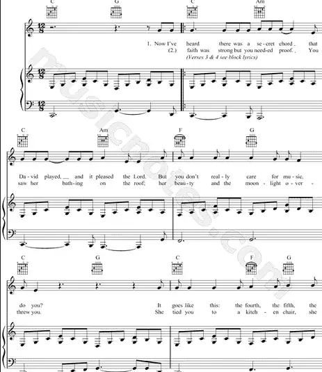

You'll have trouble playing from that page, because the chords are marked at the wrong places.
Refer to the sheet music. It will make your life much easier.

In general, we don't play chords per word, Normally chords change at measure/phrase level, depending on the style, however we play notes per melody line syllables.
Check the following answer for some suggestions.
Piano Chord example
More about melody line:
In music, a song will generally have two parts, one is melody and another is chord. Melody is the song lyric lines that we sing, while chords are the harmony music that supports the melody, normally melody will be played in the higher octave range and chords are played in the lower octave range(if we are just accompanying someone else's vocal, then we play just chords, chord in the higher range and the root of the chord in the lower range). We can assume of the melody as vocal solo and chords as background music to the vocal. In four part songs/chorals, it will have four voices generally the top voice soprano would be the melody line and the lower voices (alto, tenor, bass) would be like chords. Normally for each syllables in the lyric words, there would be a note (melody note) assigned, (in special cases a syllable would have more that one note(melisma)), but a chord will continue for a measure/phrase,
Try the following lesson Piano Accompaniment Styles

  • Hey guys, i dont think i was as clear as i could have been (and yeah the formatting changed i only just realised) what i mean to say is that i don't know where to go for the chords, do i go a higher octave, a lower octave, stay the same? I just don't know. Also when i play it, it always seems out of place and doesn't fit to the song at all. It sounds like someone forgot the chords and just pressed whichever chord they thought would work. But it doesn't. Also with the sheet music i can't find for a lot of the songs i wish to play (this isn't just about Hallelujah) – Jules Oct 21 '18 at 12:11
  • Also Bruce i think you understand what i mean, although i don't think i completely understand the melody line syllables, could you please elaborate? Thanks – Jules Oct 21 '18 at 12:24
  • updated my answer with more details. – Bruce Oct 22 '18 at 04:44
