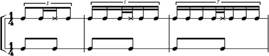

  3. Otherwise, I found it good to make sure I know where is the exact half of the tuplet. Practicing like this:
triplet, quintuplet and heptuplet against normal eighth notes
where the crossed note is first played (tapped) quietly and later just imagined, was quite helpful to me, even if you don't need to play the 3/5/7/whatever-against-2 polyrhythm itself. A good time to practice this is when walking (which naturally gives you the rhythm in the lower staff) --- you can silently tap the upper staff. (I think it can help with more complex polyrhythms too: you could make sure that the "halves" of both tuplets occur at the same time.)
