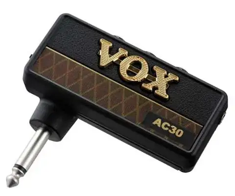

You can always turn an amp down low, but to avoid disturbing sleeping flatmates you want a headphone amp:
