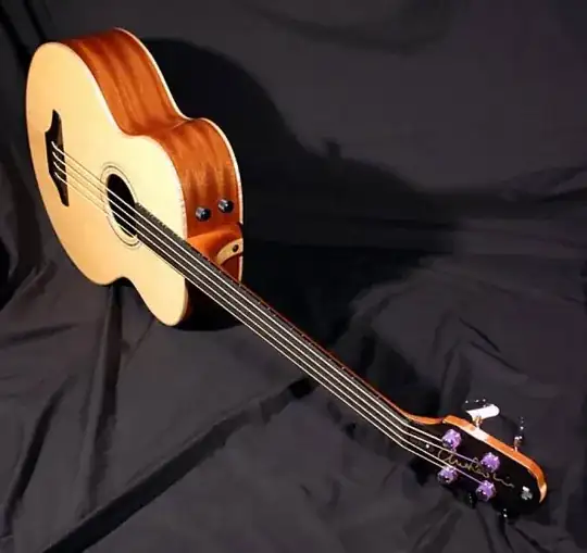

When we play as our alter ego band Acoustech (we play folk and acoustic blues arrangements of our metal songs :-) , I use a 12 string, my rhythm guitarist has a fairly loud acoustic guitar, but our bassist is easily loud enough to work without amplification. He has a fretless acoustic bass, custom made for him, but the only key point for volume seemed to be the body size (standard guitar shape, but larger) and the structure of the ribs in the soundboard.
Here's a picture of his bass, on luthier Chris Larkin's website:
I will try and find out exactly how they are arranged, but excluding that I would just suggest playing a range of acoustic basses and checking the volume for yourself.
Ones with f-holes may be louder, but even then size seems to be key.
