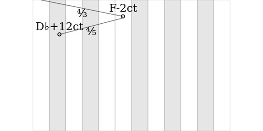

Pythagorean, downwards
Fifths downwards and fourths upwards.
onKeyboard $ constructNote PreferFlats [4/3, 4/3, 2/3, 4/3, 2/3]
D♭ constructed in Pythagorean tuning
So you see, this D♭ is 24ct flatter than the Pythagorean C♯.
