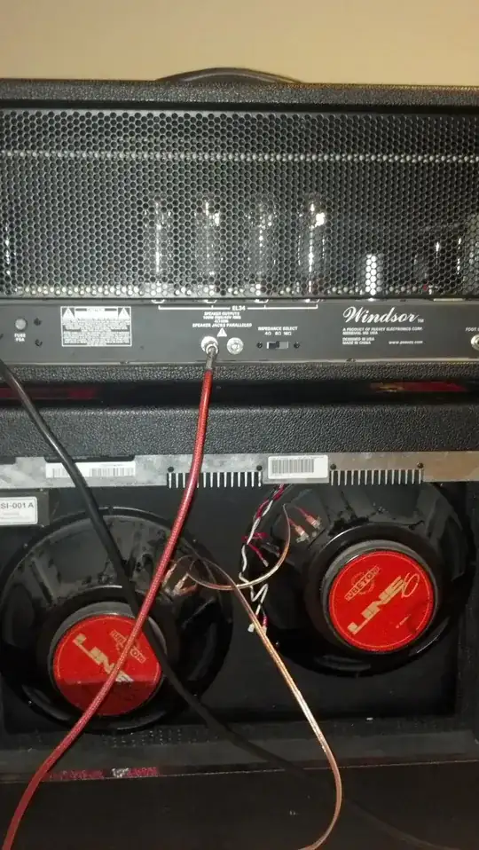

I figured it out using Shavano Music as a reference for the wiring. Since both speakers are 8 ohms, when wired in parallel, the total impedance is 4 ohms.
2 speakers wired in parallel
I disconnected the original wires from the speakers and used a 1/4" phone jack from Radio Shack to connect a guitar/speaker cable to the speakers.
Rewired Line6 Spider
You can't see the phone jack in the photo, but the red-ish cable coming out of the Windsor head is connected to the speaker wire on the floor (via previously mentioned phone jack). I've since drilled a hole in the back center of the Line 6 near the top (directly below the Windsor output jacks) and inserted the 1/4" phone jack there.

Connection-wise...you're correct. The other thing to keep in mind is, though guitar and speaker cables both have 1/4" plugs...the wiring is much thicker (heavier gauge) in a speaker cable. As that amp is an EL34 (4 tube output) head, I would have just soldered a 1/4" plug onto the copper speaker wire I see there. Looks like it would reach. That would give you a proper gauged wire for the speaker connection. It will then free up the guitar cord for something different.
If you used the amp at high volumes for lengths of time, you could end up heating the guitar cable...possibly to the point of melting the separate wire insulators in the cable...hence, causing a short and possibly burning up the transformer on the amp.
Cheers! Brad
