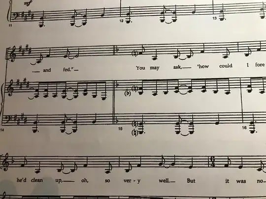

Sometimes there's a NEED to modulate, perhaps to accommodate vocal range. Here's a wonderfully ingenious example of sounding as if you've done a 'truck driver' up into the last chorus but actually ending up a semitone LOWER to the rest of the song!
