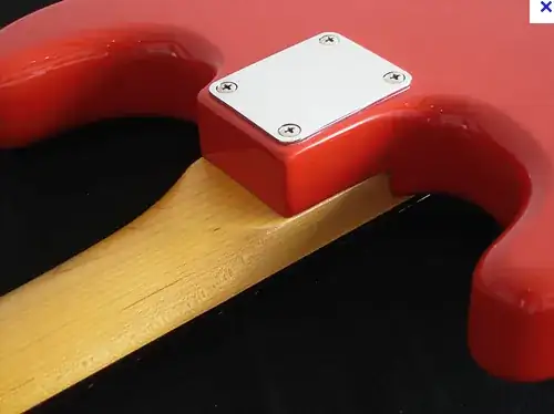

How the neck is attached to the body
A neck can be:
  • bolted to the body ("bolt-on")
  • glued in ("set neck")
  • the neck runs the entire length of the body ("neck-thru")
The conventional wisdom is that the bolt-on design has less sustain than the set-neck construction. However, various guitar manufacturers dispute this and say that a properly constructed bolt-on neck construction can have just as much sustain as a set-neck design. Everyone agrees that the most sustain comes from the neck-thru design, but this is not common in guitars because it is a much more expensive method of construction.
Bolt-on neck
