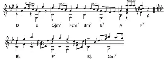

Perhaps not what you are looking for, but I recall "Sampo" (Stroll) from Joe Hisaishi (opening theme of "My neighbour Totoro") which in the reprise repeats the full song a semitone up. In this guitar arrangement of mine, you can see (and hear) the simple modulation: from the concluding chord (tonic) of A major, with higher note A, the chord is suddenly replaced by F7, (keeping the A high note) - this is the dominant of Bb, which turns to be the new tonic.
