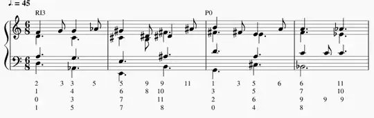

I strive to write relatively consonant 12 tone music, and try to reflect the tonal nature of the harmony by using standard chord spellings. However, in order to keep the chord spellings meaningful, the melodies often end up with the awkward intervals you asked about. This often happens in heavily chromatic music.
The example below illustrates how a diminished 4th and diminished octave can come about. Measure 1 starts with a Dmin triad and an AbMaj7, followed by an C#min and BMaj7 in measure 2. The bass is { D, Ab, E, B } and the melodic intervals between those notes are an augmented 4th, diminished 4th, and Perfect 5th.
The suprano is { F, G, Ab/G#, D#, A# } and the melodic intervals are Major 2nd, minor 2nd, Perfect 4th, Perfect 5th.
For the base in measure one, I could have used G# instead of Ab, renaming the augmented 4th to a diminished 5th, and the diminished 4th to a Major 3rd. However, then we would have G in the suprano against G# in the bass, giving a diminished octave!
In the end, these strange intervals come about because our staff and interval naming was based on the diatonic system, consisting of only 7 steps, while modern music uses all 12 intervals.
