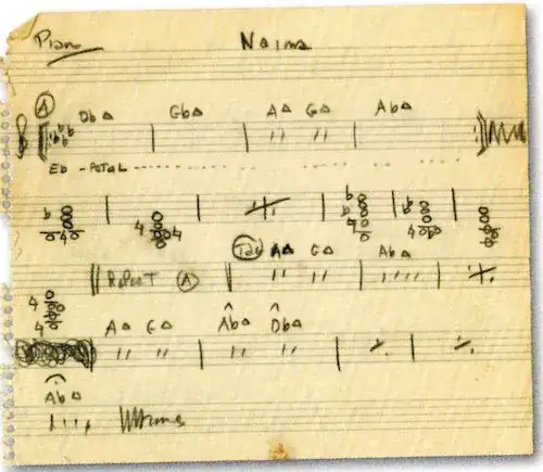

An article on the origin of the "delta" symbol has been doing the rounds recently. It quotes a book by Yusef Lateef, which claims that John Coltrane introduced the "triangle notation" for a major 7th chord:
"DELTA (△) SYMBOL. Introduced into music notation to symbolize a major seventh chord by the late John Coltrane."
Chart for Naima, probably written by Coltrane himself in 1959
The second part of the article does some more sleuthing, but is inconclusive:
I'm not sure we can draw any conclusions here, but [for what it's worth], it looks as though both Coltrane and Shorter were using the symbol by 1959. In Coltrane's case, perhaps not earlier. Wayne used a "△7", Coltrane just a "△".
It would seem that the symbol was not in use (in jazz, at least) before 1959.
I understand that the symbol "originally meant 'triad'", although I'm not sure whether it was ever used extensively in charts. When did its meaning change to maj7? Who popularized it?

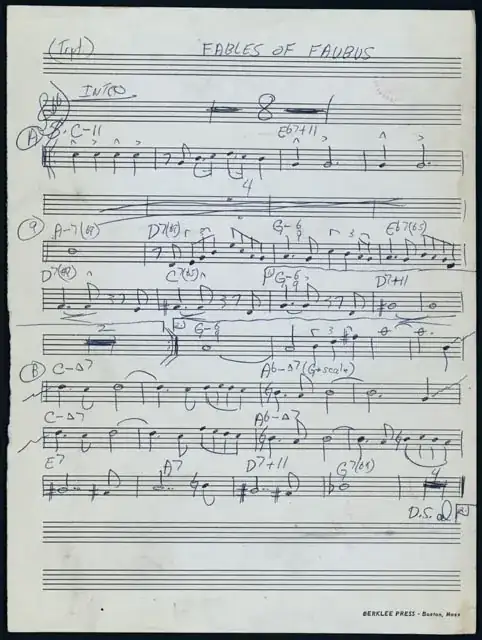

The first documented usage that I have seen of the ∆ symbol in jazz is from Charles Mingus in 1957. The Civil Rights Digital Library contains this entry for a trumpet score handwritten by Charles Mingus and dated 1957 according to the record:
http://www.loc.gov/exhibits/brown/images/br0131s.jpg
In the B section, we see these chords: C–∆7 and A♭–∆7. As you surely know, the minor major seventh chords contain an augmented triad like the one drawn inside the circle of fifths. In C–∆7 the augmented triad is E♭ G B. Perhaps the equilateral triangle symbol, which earlier in history was synonymous with an augmented fifth, was first used in jazz to indicate the major minor seventh chord (e.g., C–∆7)--a chord which at the time had no other symbol associated with it. This is consistent with the documented history of the ∆ symbol, which shows its first usage in a minor major seventh chord, not a maj7 chord.

    Wow, really interesting answer. Do you know of any charts by Mingus around that time that use augmented triads? If so, how does he label those? I see he labels the "G+" scale along with the A♭–∆7; does he also use + for augmented triads? – Richard Jun 12 '17 at 18:55
  • That's a great question, and I wish I knew the answer. It would be telling if he had used ∆ for augmented triads, although I'd probably to expect to see the + notation given that this was common practice at the time and there was no need for a different/new notation for augmented chords. Reserving the ∆ for minor major seventh chords and the + for augmented chords also could have had the benefit of distinguishing between the two scenarios. – jdjazz Jun 12 '17 at 20:21

  • Lastly, here's another manuscript of Fables of Faubus that appears to have the Library of Congress stamp in the top right corner. This manuscript is written with E+7 in the B section (this would be a E G♯ C D chord). I'm also not sure when this was written though, and the handwriting definitely appears different from Mingus's. – jdjazz Jun 12 '17 at 21:01
