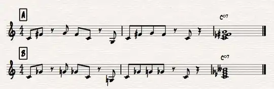

The trivial answer is that by choosing to call it C - F# you've defined it as an augmented 4th. 4 letters, C,D,E,F - make a 4th. If you want some sort of 5th, call the top note some sort of G. End of.
But there's a solid question here too. We often write a sharpened 4th rather than a flattened 5th. You're more likely to see a melody and chord written as A in my example than as B. But harmony theory prefers to call the interval a b5. There's a simple reason. Common Practice (and Jazz) theory likes everything to be a triad, an extension of a triad, or a modification of one of these. The 'pile of 3rds' thing. It will just about tolerate an added 6th, and goes all shifty when the 11th comes up. But, mostly, it likes triads. Therefore conventional chord naming prefers a modified 5th - which is a triad note - to a modified 4th.
