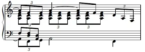

In transcribing a work for piano with two voices in each staff, I've come across a passage in which there are two voices in the LH staff for some duration, but in one measure there is only one voice played for 3/4 of the measure and then a 3/2 tuplet of 8th notes.
There are four ways I can notate this:
  1. three quarter rests on top of staff
  2. a half rest followed with a quarter rest (because when resting for part of a measure, it seems "normal" to place them in descending duration)
  3. a quarter rest followed with a half rest (to match up with the lower voice's tuplet and minim)
  4. nothing at all (lower voice's notes fill the measure)
Refer to the below image for examples of each of the four ways (respectively):
Notation examples (4) as described above
I'm a little unsure what the best way to represent this (I'm using LilyPond), so I'm asking: From a performer's, professional musician's, and/or composer's perspective, what is the best way to represent this in notation? "Best way" meaning least confusing, most common, and/or easiest to understand. Both voices have notes in the prior and subsequent measures.

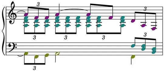

In this excerpt there appears to be three distinct voices (I've added some colour for clarity):
  • The top voice (the melody) stays in the treble staff.
  • The middle voice (the harmony) starts off in the treble and moves to the bass.
  • The bottom voice (the bass line) stays in the bass staff.
At no point are any of the three voices resting, so it should look like option 4:
Three voices, with the middle voice crossing staves, without rests.  The melody stays in the treble staff.  The harmony is in the treble staff for the first three beats, then moves to the bass staff. The bass line stays in the bass staff.
Another way to represent this that separates the harmony from the melody visually, would be to move the middle voice to the bass staff for the whole measure:
Three voices, without rests. The melody stays in the treble staff.  The harmony stays in the bass staff.  The bass line stays in the bass staff.
However if I am misinterpreting, and there really are four voices in the piece, you will need rests in both staves: a crotchet rest at the end of the measure in the treble, and a minim rest followed by a crotchet rest for the start of the bass staff; it should look like this:
Four voices, with rests.  The melody stays in the treble staff.  The upper harmony stays the treble staff, resting for the last beat.  The lower harmony is in the bass staff, it rests for the first three beats. The bass line stays in the bass staff.
Notes (assuming four voices):
  • Options 1, 2, & 3 are not right, as you are missing a rest for the upper harmony.
  • Option 1 is also not right, as some of the rests can be merged.
  • Option 3 is not right, as the minim rest should not span across the centre of the measure.

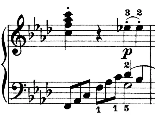

It is fine for the notes in a stave to be notated as if in one voice for part of a bar/measure, but in two voices for the rest. Here is an example from the finale of the first work I checked: Beethoven's Piano Sonata 1 in f minor.
Beethoven Piano Sonata 1 in f minor, finale, b.5
