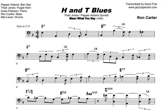

I accepted an answer so I won't answer my own question, but I will add this bass transcription of 'H and T Blues' which is essentially the Basie Blues progression. Note that the bar 7 chord is written with slash notation to show that the 2nd inversion is used. That matches @StevesOnBass's answer, but I like having a transcript from a great player.

  • Regarding the 6/4 chord and bass movement Bb B C... That kind of motion to a 6/4 chord on beat ` may actually be normal in blues style. https://music.stackexchange.com/a/77671/23919 – Michael Curtis Jul 09 '19 at 16:51
