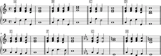

Not only are there inconsistencies between UK and American terminology, there are inconsistencies within just the American terminology! You're 100% correct that an "authentic cadence" is V–I, but it can be a bit more complex than that; here I'll give you the "academic" way of understanding classical cadences.
  • At A, we see the common Perfect Authentic Cadence (PAC). It's labeled such because both the V chord and the I chord are in root position and the soprano ends on scale-degree 1.
  • At B, we see the Imperfect Authentic Cadence (IAC). It's labeled this way because, although both the V chord and the I chord are in root position, the soprano ends not on scale-degree 1, but on scale-degree 3. (It could have also ended on scale-degree 5 and still been an IAC.)
From these two definitions, we see than an Authentic Cadence (AC) involves a V chord moving to I and both are in root position. This latter part can be contentious, but a number of music theorists, from Heinrich Schenker to William Caplin, have insisted on the V chord also being in root position. (More on that later.) The distinction between Perfect and Imperfect solely rely on the soprano scale degree.
  • At C, we see the standard Plagal Cadence. Note that some theorists don't consider this a "real" cadence per se because there's no V chord. I think that's silly, but from a standpoint of Schenkerian analysis, I understand why they say that. (In short, the Schenkerian mindset is that music is, at its most basic, a motion from tonic to dominant and back to tonic. If there's no dominant, there's no complete musical motion, thus no cadence.)
  • At D, we have what we in America call the Deceptive Cadence (DC). It typically moves V–vi, but really it can move from V to anything that's not I. (Note that some distinguish a Perfect Deceptive Cadence from an Imperfect Deceptive Cadence based on what scale degree is in the soprano, but this is pretty rare.)
Now, here's where the inconsistencies between textbooks come in:
  • At E, note that the cadence ends with IV6–V6–I. Some textbooks (like the Kostka/Payne) will call this an IAC because the V is inverted. Though this is one way of viewing it, the majority of professional music theorists will call this a Contrapuntal Cadence (CC) on account of the stepwise motion in the bass. In short, if one or both of the final two chords is/are in inversion, it is a Contrapuntal Cadence.
  • At F, we have a similar issue, but here both the final chords are in inversion: the V quickly moves through a V42 into a I6. You can call this a Contrapuntal Cadence, but it's such a common progression that it has earned its own name: an Evaded Cadence (due to how the bass quickly "evades" the feeling of closure with a root-position tonic chord).
Edit: Since I'm here I figured I might as well include some discussion of half cadences as well, even if they weren't addressed in the original question.
  • At G, we see the standard Half Cadence (HC). For a half cadence, all that matters is that it ends on a root-position V chord. (But again, some think a HC is possible with an inverted V chord.) There's also a disagreement on whether or not this V chord can include a chordal seventh. I think a V7 is fine to create a HC, but some disagree!
  • And at H, we see a more specific type of HC. Due to the half-step motion in the bass from the iv6 to the V, this is called a Phrygian Half Cadence. This must be a half step in the bass; if we move from IV6 to V in major, with a whole step in the bass, this just goes back to being a regular HC.
