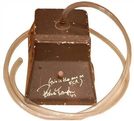

In Tokio 1992 Slash used what looks like an air tube to change the sound of his electric guitar. What is the proper name of this mechanism? And what is the mechanism behind the sound changing?

It's a "talk box".
It works by projecting the sound coming from the instrument (typically a guitar) into the mouth of the performer (the tube is coupled with a speaker inside the box). The performer then modulates the sound using their mouth, pretty much as if speaking. The resulting sound is captured by a microphone.
The resulting effect is similar from that of a purely electronic vocoder (both effects apply human voice formants to pitched sound), although of course the Digital Signal Processing performed by vocoder allows for much more effects and dramatic transformation of sound than the purely acoustic talk box.

Good point Tim, vowels are indeed the formant component of our voice, produced by changing the shape if our mouth. Consonants are produced by movement of the larynx, lips, or tongue and so are nor able to modulate the external sound coming into the mouth. The sound of the consonants can still be picked up by the mic and so become part of the overall final sound, to some extent, but not articulated very clearly and certainly not pitch modulated by the guitar. – José David Sep 15 '16 at 18:23
That's his original box in the picture, apparently preserved for posterity with is signatures on :-) – José David Sep 16 '16 at 06:49
As joseem already said, it's a talk box.
The human voice can be (roughly) divided into two components: the base tone, generated by your vocals chords, and the formants, which are modulated onto the base tone using your mouth.
The talk box is literally nothing more than a tiny guitar amp with the speaker enclosed and a hose attached to the enclosure, so that the sound pressure wave is forced into the hose. You put the hose into your mouth and then the guitar acts to produce the base tone instead of your vocal chords. You can modulate that base tone normally (within the limits pointed out by joseem), and thus make the guitar "talk".
A vocoder does the same thing, but electronically. It separates the base tone from the formants from two instruments (your voice and some arbitrary second signal, typically a synthesizer) and imprints your voice's formants onto the other instrument's base tone. It sounds less "organic" than a talk box, but because it uses your actual voice as input, it can pick up formants that you just cannot produce with the external stimulus of the talk box (after all, you have a hose sticking in your mouth, so what you can do with your lips, teeth, and tongue is limited).
