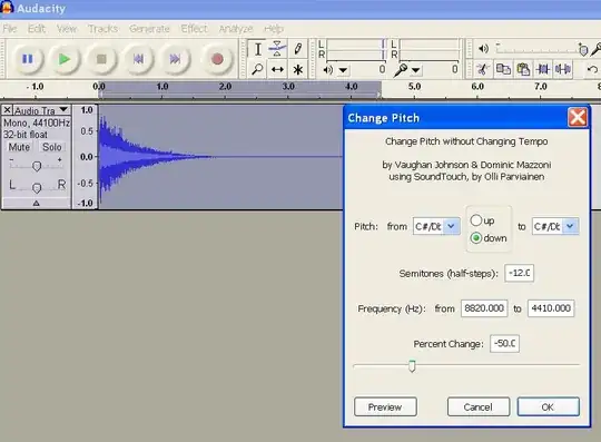

Audacity can do this. It's free on Windows, Mac and Linux.
Load the audio file. Select-All (ctrl-A). Choose "change pitch" from the "effects" menu, and you will be presented with a range of options.
This adjusts the pitch independently of the speed, with some loss of quality. The "change speed" option in the same menu will affect both speed and pitch, but with less impact on the audio quality.
Even for those without perfect pitch, this is a great feature for people wishing to play along to recordings which are not at standard pitch.
