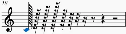

Musescore 3.6.2.548021803 has support for notes up to 1/1024.
By default, it will show 1/32 notes in the toolbar only. If you switch to extended mode, you get 1/64 and 1/128 in the UI as well. By assigning key combinations in the settings, you can access 1/256, 1/512 and 1/1024.
However, this does not seem to be thoroughly tested. After adding a 1/1024 note, the pauses are not sorted correctly, IMHO:
1/1024 note in Musescore 3
