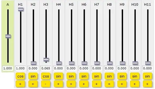

As naught101 says, your particular case here is a sinusoidal wave with a quiet third harmonic. To hear what this sounds like at an audible frequency, go to http://meettechniek.info/additional/additive-synthesis.html in a browser that supports the Web Audio API (like Firefox or Chrome), turn the audio on, and set it like this:
H1 there represents your (16/15)cos(½ t), although as the default frequency of this online synthesizer is 440, we've effectively scaled it to cos(440 × 2π × t), and (16/15) has just been normalised to '1.000'. H3 represents the -(1/15)cos(2t) bit, again scaled up in frequency - ideally the volume would be 0.0625, which is 1/16 of the volume of the fundamental (H1), but 0.065 is close enough.
You may not find it sounds that interesting after all! In fact all waveforms that are strictly periodic with no variation tend to sound quite boring (to me at least) - they'll all just be a static hum or buzz. It's usually the variation in the shape of the waveform over time that makes it sound interesting.

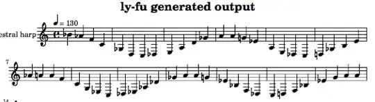

Equations could be fed into e.g. SuperCollider. Another option is to "fencepost" the equation and convert the value of the equation at those points into a pitch (and possibly also a duration, perhaps based on the slope at that point, or whatever), though this will require some amount of fussing to appropriately scale the fenceposts (what the x values are) and output (y values) to fit into a suitable ambitus:
% perl -e 'for $x (0..10) { printf "%d\n", 60 + 10 *( 16/15*cos(.5*$x) - 1/15*cos(2*%x) ) }'
70
68
65
60
54
50
48
49
52
57
62
% perl -e 'for $x (0..100) { printf "%d\n", 60 + 10 *( 16/15*cos(.5*$x) - 1/15*cos(2*%x) ) }' | atonal-util pitch2ly --mode=absolute | ly-fu --instrument=orchestral\ harp --open --absolute -
