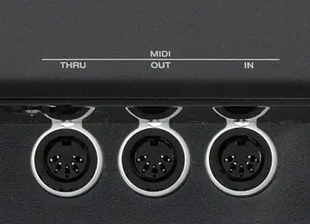

Firstly, does your USB keyboard have MIDI out (DIN) sockets as well... enter image description here ...or is it USB only?
If it is USB only, then it is possible to get a hardware converter (from USB to traditional 'DIN' MIDI) that should work as long as the USB Midi keyboard is 'class compliant'. an example is http://www.kentonuk.com/products/items/utilities/usb-host.shtml.
Once you have a traditional (DIN) MIDI connection, you'll be able to use any midi sound module. Many years ago, these boxes were the most usual thing to use with a midi keyboard - often with a computer-based midi sequencer in between. These modules are also sometimes called 'expanders'.

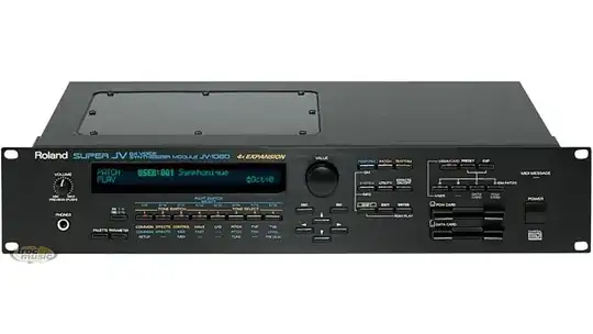

The Roland JV-1080:

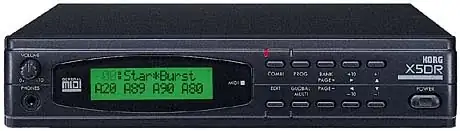

The Korg X5DR:
Of course when buying something that may be 20 or more years old, you'll want to consider that reliability may be an issue before laying your money down.

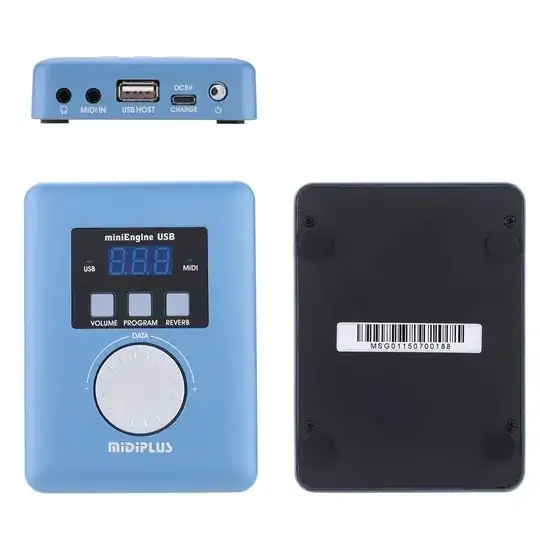

If you want to go really cheap, I found this little sound module on Amazon that costs only £50. Haven't tried it, but it should get the job done. Accepts both USB and MIDI as an input and in the product description states that it can power up a MIDI keyboard.
Ammoon Midiplus MiniEngine, and
Ammoon MIDIPLUS MiniEngine Pro
m.spyratos
  • 186
  • These things look like great value, although the sounds are not all that inspiring. See https://www.youtube.com/watch?v=j3p8080P0zc for example. The actual product details are available at http://www.midiplus.com/products/other/54.html?lang=en . It would be pretty nice to know a bit more about the method of synthesis, but the manual is pretty sparse. – naught101 Feb 19 '18 at 05:40
