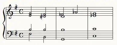

Yes, you need a chromatic modulation, if you don't want to use another key for the modulation.
This is maybe the simplest one.
octo
  • 51
  • Where's the B-flat sus4 chord? Are the Bs in the second chord supposed to be flat? – Todd Wilcox Sep 16 '15 at 18:17
  • The main question is how to modulate from e-minor to c-minor. The user had a question about Bb-sus chord, which is not found in e-minor neither very useful as a modulation tool to c-minor. Therefore, my explanation offers a solution to modulation from e-minor to c-minor. – octo Sep 16 '15 at 18:58
  • I guess it depends on what part of the question one sees as the essential part. I was keying off of: "...I'm struggling to find something that moves me smoothly to the Bbsus. Any thoughts?" – Todd Wilcox Sep 16 '15 at 19:03
  • I agree. But Bb-sus is already Eb-major which is very far away from e-minor, and therefore very close to c-minor. If you need to have Bb-sus in e-minor and still not entering c-minor: it is very hard task. I would like to see how Tracey's progressions are moving and where it stops. – octo Sep 16 '15 at 19:09
  • @ToddWilcox you're right, my issue was/is getting to the Bbsus from E minor. I don't have time to figure out how to insert an image of the section but the progression is i (Em) - i (Em7/D in bass) - iv6 (this is where I'm struggling...changing E to Eb helps, I'm just not sure it's enough) - Bb sus - Bb - Cm. Sorry if that's confusing, I couldn't figure out how to insert the image :-) – Tracey Sep 17 '15 at 15:00
  • Bb (yours sus: Bb4/5) is so-called the polar chord, it is the farthest available chromatic chord in a scale in the tonal system, since it is found on a tritone. There are numerous possibilities to come to that chord, but the following point you have to keep in mind: P-chord is very far away. If you use it as an exception (Liszt, Dvorak) you must therefore to return back to your original key (e-min). But if you want to use it as a modulative-chord (use it to go to the another key) it will sound very unstable. Therefore, you need to reach c-minor (or Eb-major) before entering Bbsus4 (Bb4/5). – octo Sep 18 '15 at 06:14
