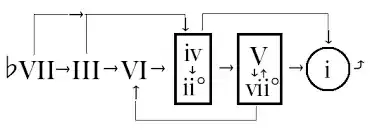

There are several summaries of common chord syntax based on a given style. Like this one in Kostka & Payne which is meant to model common-practice tonal music syntax. Note that this is based on the circle of fifths which is understandable but can be critiqued in that one can easily argue that not all idiomatic progressions are derived from the circle of fifths progression.
Kostka & Payne Chordal Syntax Chart
Or the one on page 37 of this article by Tymocko.
Note that Schoenberg's famous chart of the regions (mentioned above) is more of a map of key relations, but doesn't prescribe a suggested or typical syntax. In fact Schoenberg's HarmonieLehre has surprisingly little advice or commentary about chord syntax.
