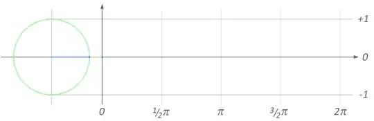

I could write several pages on why sine and cosine are not merely simple periodic functions, there are actually the simplest possible ones, but I don't think this is the best place for that. Let me briefly say, however, that a circle is perhaps the simplest shape, and if you follow a point as it goes around a circle, its vertical movement traces out a sine wave at the same time that its horizontal movement traces out a cosine (this depends on where on the circle the point starts, but one will be sine and the other cosine, or at least one will be one quarter cycle behind the other in phase).
Below is a video of that, and hopefully this will give you a way to see how the sine wave (or cosine, same thing, really) is the simplest periodic function, and therefore the one we want to break more complicated functions into, and also the one that to our ears appears to be the most basic if we turn it into sound.
See also the Physics version of this question with a similar answer: https://physics.stackexchange.com/questions/352754/why-cosine-and-sine-functions-are-used-while-representing-a-signal-or-a-wave
Circle tracing sine and cosine functions

Because a circle is the purest periodic shape:
Circle tracing sine wave
