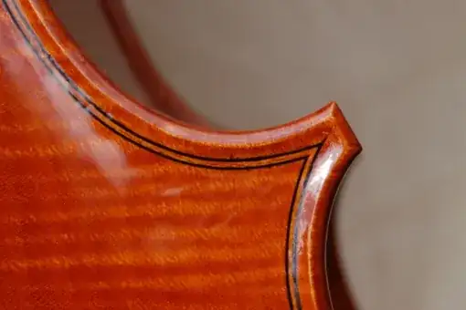

  • A first good thing to check is the purfling, visually: the inlays should be genuine, three layers : normal wood sandwiched in two layers of black wood. You can spot that because the wood in the purfling should have a varying and different orientation from the table or back wood figures (see the picture). Low quality cello (and violins, violas) have sometimes painted or otherwise faked purfling.
