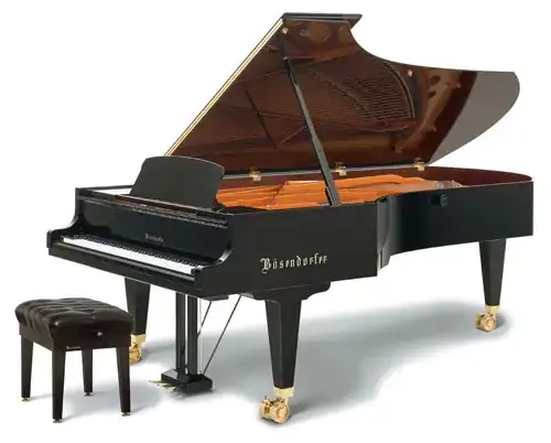

You must not have heard of the Bösendorfer Imperial 290 piano, which has 9 extra notes lower than "A", for a total of 97 keys. The soundboard is 2.9 meters in length. It is a popular model in large churches and concert halls, but it is very expensive at around €150.000. It has been on the market for more than 100 years. The Bösendorfer company is in Vienna, Austria.
For 100 years, Bösendorfer has owned the market for anybody who has a special need for a piano that goes below the conventional low "A".
The existence of the Bösendorfer 290 and its 100 years of success proves that there is no technical reason that the conventional low "A" is some kind of limitation that cannot be overcome. However, to the best of my knowledge, no other piano company has ever mass-produced another model of piano with notes lower than the conventional low "A".
The obvious reasons why all other piano manufacturers stop with the low "A" are that economic factors would make it impractical for them to copy what Bösendorfer has succeeded in doing. It seems to be that developing the tooling to manufacture such a huge piano would be too expensive, that the pianos would have to cost a great deal of money, and that there would be a limited number of people willing to buy them.
Furthermore, as the standard low "A" has been established for about 150 years, there are virtually no compositions that call for a note lower than the low "A". I suspect that composers have not written any music that calls for lower notes because those composers either did not have access to a Bösendorfer 290, or that they realized that it was unlikely that other musicians wishing to buy the sheet music and perform those compositions would have access to a Bösendorfer 290 upon which to play them.
The fact that a piano can go down to low "A" depended entirely upon the railroad and shipbuilding industries of the 1800s. It had little to do with the wishful thinking of artistic considerations. Read on and I will explain.

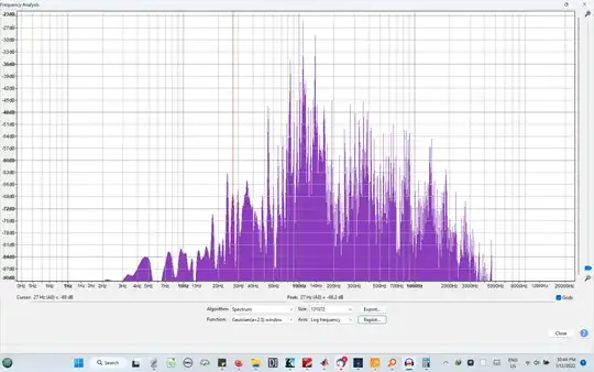

Whilst the lowest note on the standard grand is A0 with a frequency of 27.5 Hz in fact the piano does not radiate these frequencies to an audience more than a meter or so from the sound board. This is because the wavelength of sound at 27.5 hz is ~12.5 meters. A concert grand with a sound board of 2.5 * 3.5 meters is far to small for it to radiate the fundamental base notes very far as the sound pressure generated from the upper side of the sound board is in opposite phase to the top so the wave cancels itself.
This is the same problem that occurs with loudspeakers for bass reproduction, which is why they have to be installed in a sealed box or a ported box tuned to the speakers resonant frequency.
With close microphones (less than 1 meter from the soundboard), which have a low enough frequency response (< 20 Hz) and with speakers having a low frequency response the fundamental frequencies of the piano low notes can be reproduced at distance.
What you are hearing when the lowest note is played is the mostly the third harmonic which is A2 at 110 Hz. This s a wavelength of 3.8 meters.
The A0 and A2 notes when played even though the lowest frequency is effectively the same the two sound quite different due to the difference in harmonic content.
For un-mic'd concert grands in a concert setting it is impossible for the audience to hear much below 150 to 200 Hz from the piano. They hear only the high order harmonics of the bass register.

    Yes and no. The average range of hearing is about 20 Hz - 20 kHz. Under laboratory conditions, some people can hear tones as low as 12 Hz. Ideal low A is 27.5 Hz; ideal low C on the Bösendorfer is about 16.7 Hz (in equal temperament), but pianos are usually stretched-tuned a bit to deal with the inharmonicities of the strings, which, in the bass, have some tendency to act like rods acoustically rather than strings, thus making for octaves that are slightly greater than 2:1. Admittedly the longer the piano, the less pronounced the inharmonicity, but there is always a little. (more...) –  Feb 11 '15 at 17:21
    So... Most people will not hear the fundamentals of the lowest notes of Bösendorfer's extensions; a fair number (especially with increasing age) will not hear the bottom notes of a conventional piano. These sub-bass notes come into their own as lower octave reinforcements of higher notes, much like 32' and (a fortiori) 64' stops on an organ. The upper partials are in most people's hearing range. –  Feb 11 '15 at 17:28
    I would say that the reason that you don't hear the fundamental is not so much that it is below the audible spectrum as that the overtones sound louder than the fundamental and tend to drown it out. It's hard for the ear to keep the pitch level from becoming indistinct at very low frequencies, especially with a note that has a lot of overtones. – BobRodes Feb 12 '15 at 02:45
    +1 on the harmonics are louder than the fundamental that is probably the correct answer – Mike Jr Of-Britt Feb 12 '15 at 05:36
  • If nothing else, the human ear is more sensitive to the harmonics than a fundamental in the extreme bass, even if they are all the same volume of the fundamental is slightly louder. – cjm Jan 19 '16 at 06:50
