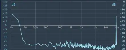

This leads us to the next "maybe": you and your equipment. Maybe you are able to hear those frequencies, but your equipment can't reproduce them. Maybe your equipment can play those frequencies, but you can't hear them. Maybe your room is canceling or amplifying some bands. If you don't have good listening conditions (room, monitors, position, ears, noise, etc) make sure you have a visual aid and know how to use them. You want to be able to see what's going on in the frequency domain using tools like Logic's native EQ, FabFilter's Pro-Q, or Live's Spectrum. It looks like this:
EQ Visualization
Here I've exaggerated the case to make my point, but it's more or less what can happen. We have a lot of amplitude in regions that can't be heard by most people, and can't be reproduced by most equipment: in 20Hz and 19kHz. And even with exotic ears and equipment they need a lot of amplitude to be heard (see Fletcher-Munson curves). In other words they don't add much (or add nothing) to your song, but they are still using your headroom. Your compressors and limiters are being triggered before they would without those frequencies.
With a visualizer you can see if that's the case, and control those bands with whatever you want. You don't have to cut them, just putting them on reasonable levels with a bell or shelving eq should be enough. It depends on taste, but some people cut everything bellow 30 to 40Hz.
